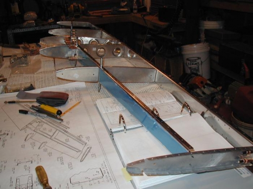

Brief Description:  Left HS ready for deburring and dimpling
Completed match-drilling the left HS skin. Drilled the outer-most holes on the HS-710 and HS-714 re-inforcements. Removed skin and re-assembled the HS left and right sub-structure to check for fit. This also gave me a chance to make minor adjustments to the edges of the ribs where the skin will attach so that there will be smooth, continuous substructure front to back on both top and bottom. The intention here is to avoid causing the skin to show a wave where it attaches to a different rib. Deburring and dimpling of the left HS is next on the list -- what fun!
Got to get a mug-shot in for the FAA
It kinda looks like the picture on the plan!
