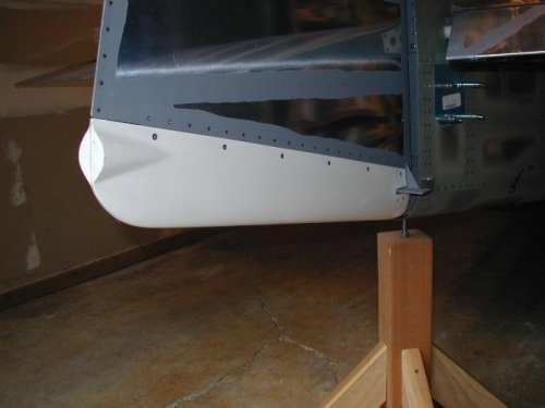

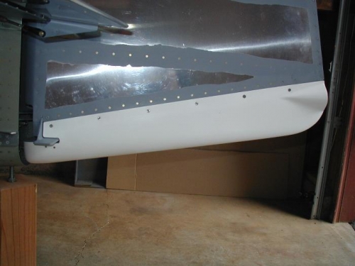

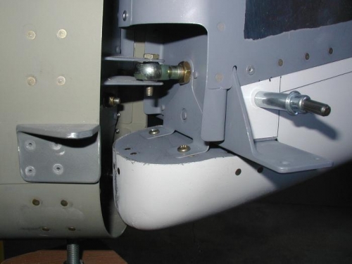

Brief Description:  Empennage Fiberglass
With the front portion cut to allow the part to slide in, it left this area un-supported. The fix was to fabricate an aluminum insert which is riveted to the fiberglass. A mount tab was also fabricated to secure this area to the rudder mounting bolt/nut. Very solid now.
New plate and mounting
Slightly different view
An opposite side view
