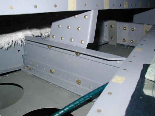

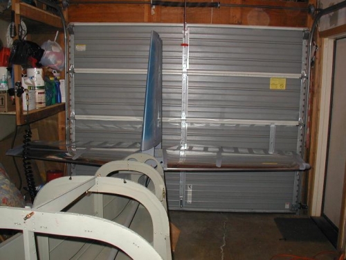

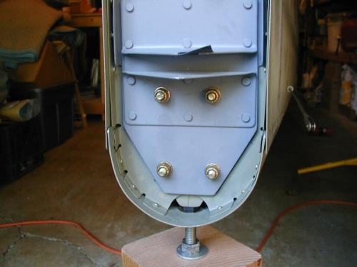

Riveted the F-781 plate to the VS. Riveted the F-712D to the fuselage. Drilled the front spar to the F-781 and bolted the VS to the HS and the rear bulkhead.
VS bolted to the rear bulkhead
F-781 plate riveted to VS and bolted to HS
VS in place
