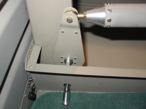

Using a 3/8
Using a 3/8" socket to center the Bellcrank for pushrod adjustment

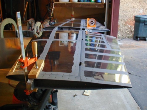

Pushrod adjusted while the Elevator is
Pushrod adjusted while the Elevator is "in trail"
