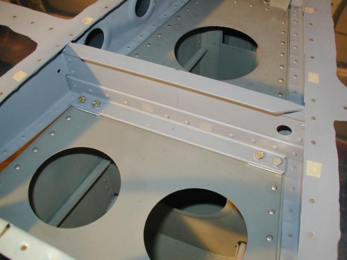

Brief Description:  Fitting the Horizontal Stabilizer
Once the HS-714 angle had been drilled, the F-798 shims were fabricated and placed in position. The holes in the HS-714 were then used as a guide to drill all the way through the longeron.
HS-714, F-798 shims bolted through deck and into longeron below.
