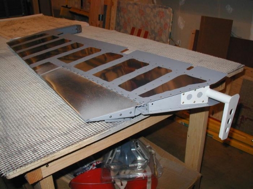

Brief Description:  Left Elevator and Trim Tab assembled
It was a long day assembling the Trim Tab and securing it to the elevator. The rivets on the bottom of the Trim Tab were particularly trouble-some. If I had it over to do, I would do either one of two ways: either use the mk-319-bs blind rivets, or back rivet them using a long extension for the rivet set and *carefully* flex the skin out of the way. ...Thinking back on it, I would prefer to use the blind rivets. All-in-all, a very good day and it's good to have this assembly behind me.
Trim Tab installed and secured in place
Counter-balance weight installed
