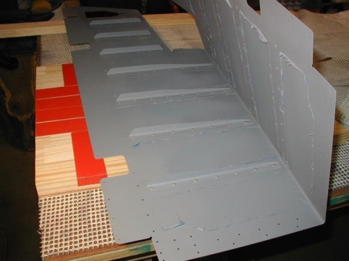

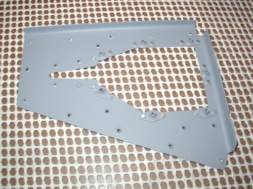

Began the day by priming the left and right Elevators skins and stiffeners. The E615 nut plate installation was next. The Nut plates appear to be made out of steel and I felt they needed to be cleaned and primed. I used the C-Frame to dimple the Nut plates and it worked just fine. The steel takes a bit more of a whack to convince it to form the dimple. Next I moved onto installing the stiffeners in the bottom skin of the left Elevator. It felt good to get back to building the RV after a couple of brutal weeks at work!
Nut Plates primed and riveted
Flush rivets on Nut plates
Bottom left Elevator stiffeners installed
