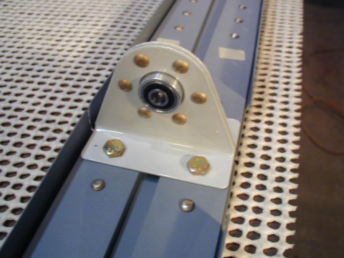

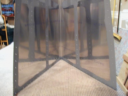

Prepared the left and right HS skins by priming the mating surfaces that will attach to the spars and ribs. Finally got to the point where rivets are driven and assembly moves forward. The rear HS spar is now riveted and ready to attach ribs and skins. The various brackets that will attach the elevators are riveted in place. The HS 411 assembly which will later be the mount for the elevator control horn is bolted with washers and lock nuts and torqued to 25 inch pounds. A very good day!
HS skins primed at attach points

HS 411 torqued in place
