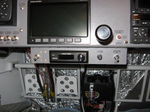

Crawled around under the panel completing the wire runs to the sub-panel with the Cowl Flap switch and Prop Controller. Not the most comfortable job, but it's good to have that behind me. The Cowl Flap switch is wired with a DPDT (On-On) switch used to reverse polarity. The Prop Controller is wired to the E-Bus via a 10-Amp push-pull breaker right next to the unit. This will be tested once the Prop/Hub is installed and the Prop Servo wires at the hub connected. I sure like the way it looks in the panel!
Back side of sub-panel with Prop Controller installed
Cowl Flap switch on the left and Prop Controller in the center
