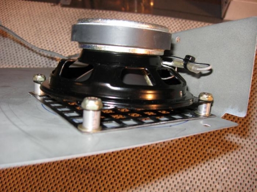

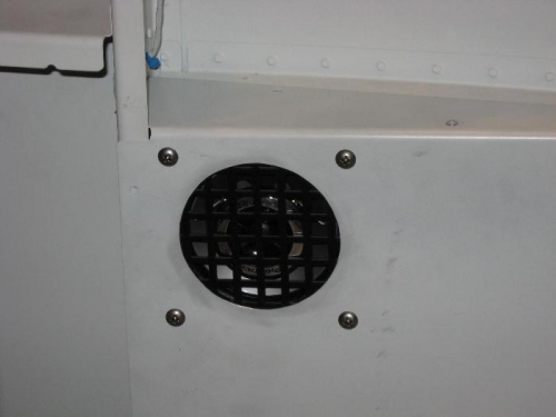

Routed the wires from the Audio panel and Dynons to the 10K variable resistor. Used two Amp 2-wire connectors to complete the wiring in this location. Ran the speaker output wire to the baggage area. Cutout the hole for the speaker in the access panel and fashioned 4 x 5/16" stand-offs to recess the speaker. Mounted a grill flush with the inside of the panel to protect things. Used a AMP 2-wire connector to finish the connections leaving enough slack for R&R of the panel. Tested the AOA Alarms and adjusted the volume using the 10K variable resistor. Very happy with the setup.
Speaker mounted with stand-offs to back of access panel

Panel and speaker in place for fit.
