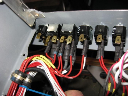

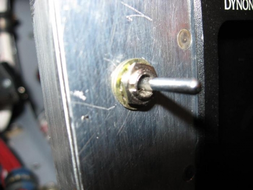

Wired from the Main power distribution bus to the Position/Strobe 2-10, Taxi/Landing light 2-10, and the Pitot heat. Installed a 15 Amp fuse for the Taxi and Landing lights and 10 Amp fuses for the Pitot Heat, Position lights and Strobe. Also drilled a 1/4" hole in the panel for the Auto Pilot GPS input switch. Began fabrication of the mounting tray for the Garmin GPS antennas (to be mounted under the cowling), leaving extra room on the tray in case I decide to do XM weather later on. Before I can mount the tray, I need to check the height of the cowling -- so this has caused me to make the 13" wooden disc to act as the prop spinner. All this just to mount the GPS antennas!
From left to right, Pos/Strobe, Taxi/Landing, and Pitot Heat
