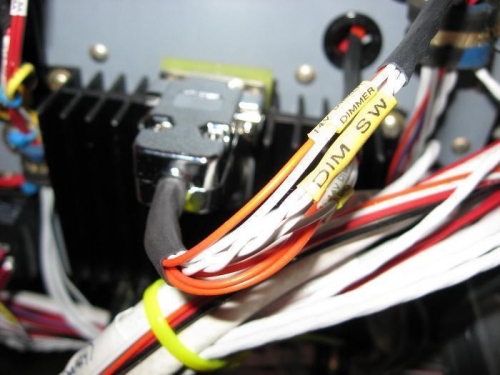

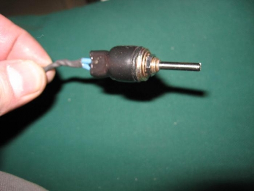

Brief Description:  Dimmer switch and wiring

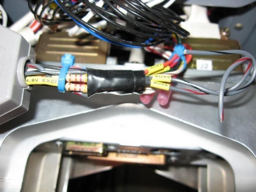

Completed the wiring for the dimmer switch. Also included the clock and the wet compass in the dimmer switch wiring. Found that the Falcon compass light did not work. Turns out the small sliding plate for the power wire did not make contact with the bottom of the bulb. Added a small dab of solder to the back side of the plate and it now makes contact just fine. All-in-all, very happy with the dimmer switch wiring and glad it's done. Really making an attempt to clean up all of the dangling wires from under the panel. Also worked on the EIS-4000 connector by removing all of the un-used wires and added the pair of 470 Ohm 1/2 watt resistors that will be needed for the fuel level senders in each wing tank.
Dimmer switch
Dimmer switch
DB-9 connector in dimmer heat sink
Resistors in place
Resistors in place
