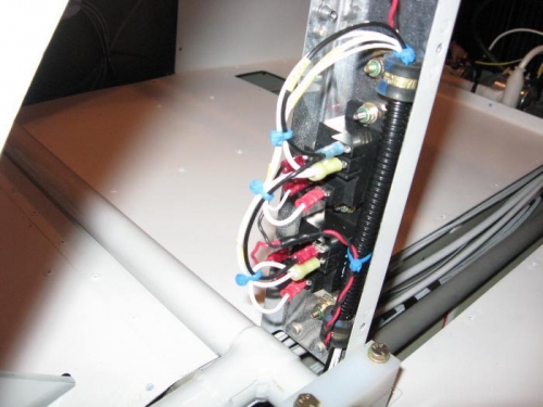

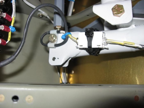

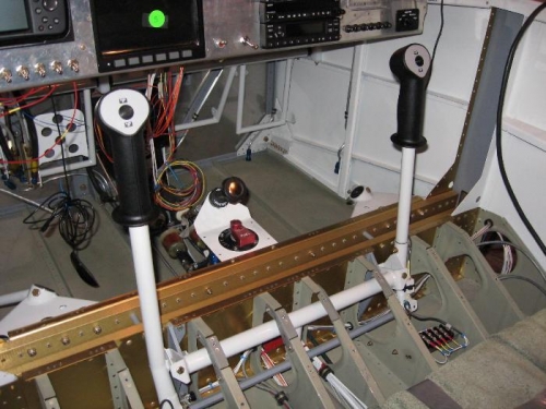

Completed the Electric Flap wiring from both control sticks. Relays are used to manage the up/down from both sticks (only one stick at a time should operate the flaps). Also used a simple RJ11 straight-thru connector for the wiring on the co-pilot stick so that when the stick is removed, it's a simple matter to dis-connect. Only very small current is passed through these small 24AWG wires.
Control sticks in place
Relays wired up
Relays wired up
Co-pilot RJ-11 RTV-ed and tie-wrapped in place
