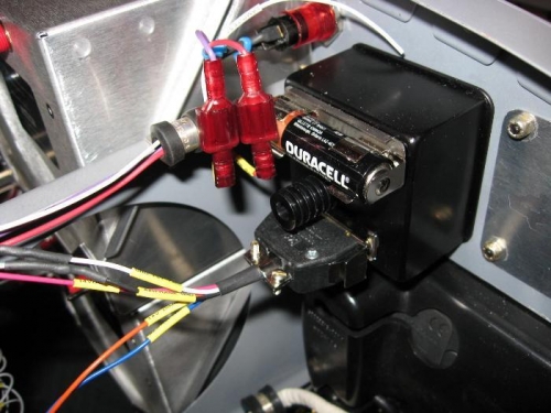

Brief Description:  Coolant Temp Sensor and Digital clock

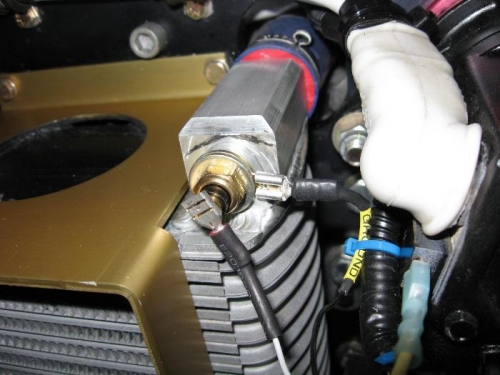

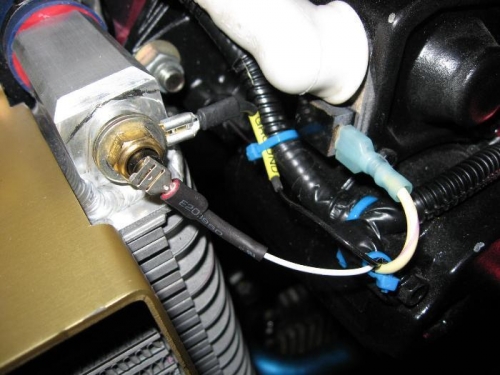

Have found that the Coolant Temperature sensor has been irratic. Contacted Eggenfellner and Gary N. indicated that the radiators are mounted with non-conductive adhesive and it's not un-common to have to add a ground wire to the outside of the sensor. As usual, he was right. I fashioned a .032 brass washer with a 1/4" faston tab (for the ground wire) and with the proper amount of washers, it's secured very tightly and provides the needed ground. Then, I started work on wiring the Davtron digital clock. Most of the wiring was completed before having to call it quits for the day.
Faston tab protruding to the right

Clock wiring started
