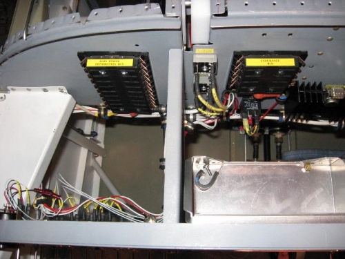

Started out by wiring up the Digital voltmeter. My first live switch! It's cool to toggle it up or down reading the voltage from each of the two batteries. Whoopee! Mike S. came by after I called him with an electrical question. It was good to have him over for advice. Afterwards, I really made some progress on the wiring. Five of the nine switches on the bottom left of the panel are now fully wired and operational. They are: DC Primary Master, Engine Battery, E-Bus Alternate Feed, Engine Primary, and Engine Secondary. Before engine start, the following circuits need to be completed: Both Fuel pumps (both battery plus and minus); ECU 5 Amp circuit (battery plus); EFI 20 Amp circuit (battery plus); Starter Button 20 Amp circuit (battery plus); and the EIS (battery plus and Minus) so that Engine monitoring can be done.

Switches getting wired -- not fully secured just yet though
More wires by the day!
