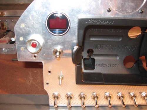

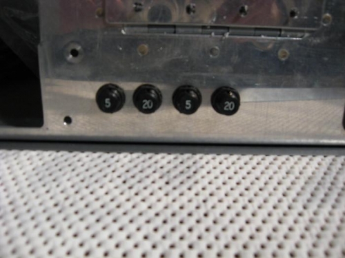

Cutouts were made in the panel for the Digital voltmeter, a switch for each battery voltage, a dimmer switch for panel lighting and 2 more breakers. One breaker is a resettable 5 Amp for the ECU circuit and the 2nd breaker is a resettable 20 Amp for the Starter solenoid. The plan for tomorrow is to get the fuel pumps mounted and plumbed up for good.
Voltmeter and it's switch; dimmer switch
Two new resettable fuses
