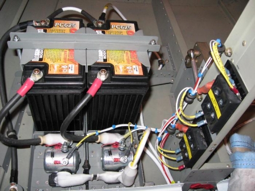

Started out tonight by running 6 x 16AWG wires plus 4 x 22AWG wires from the panel switch area down through the center channel back to the batteries. Then moved on to putting the lugs on the Postive and Negative battery cables, and securing them in place. Finished up by labeling the 10 wires and crimping ends to complete this end of the connections for the Main and Engine busses. Next is back to the panel area to finish off the end of the wires to the switches. Getting closer to the big day when the Engine is first started!
Cables all labeled and secured

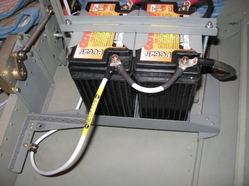

Ground cable going forward to Firewall.

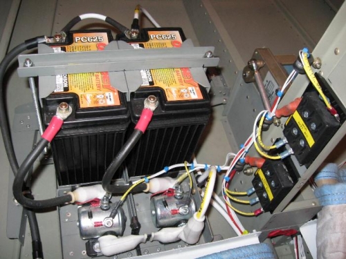

Another view because it looks so nice!
