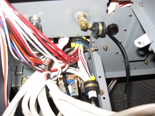

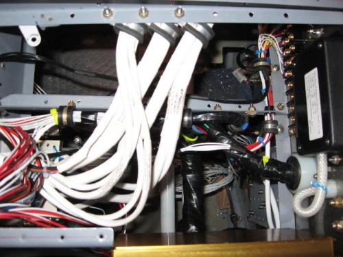

Brief Description:  General wire routing
Fabricated the ground wire between the Engire Ground bus and the Avionics ground bus using 5 x 18AWG wires. Added lots of DG clamps and support for the big wire bundle from the Dynon's and AutoPilot (AP). Ran the remote compass wires for each Dynon down through the fuselage center tunnel. Also ran the AP servo wires along with the Pilot and Co-Pilot PTT lines. Basically working to clean up the upper fuselage area to make wiring easier.
More cleanup of wires
Dynon's and AP wire bundle supported through bulkhead
