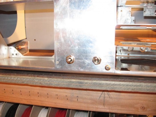

Brief Description:  Panel - switches and sub-panel cutouts
Cut the hole for the starter push button. Added the Flap switch and the AutoPilot Master switch. Spent a couple of hours riveting the Map Box together. I'm not fully decided about the Map Box going in the panel instead of below in a center console, so I will hold off on that and the IPod panel dock until later. Made two cuts in the subpanel behind the transponder to allow the DB-25 and the coaxial cable to connect. These holes have a snap bushing and edging grommet to protect the cables that pass through the panel.

Flap switch on left, and A/P Master on right
