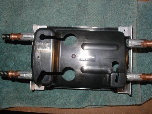

Brief Description:  Panel - Compass, Clock template, AirGizmo tray

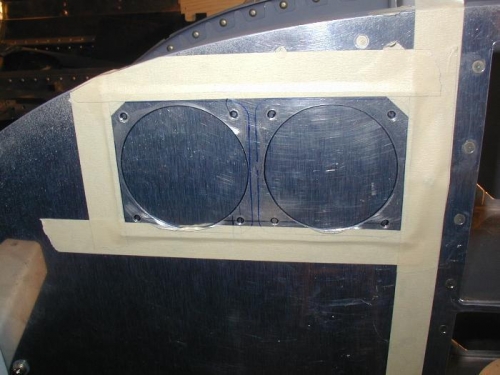

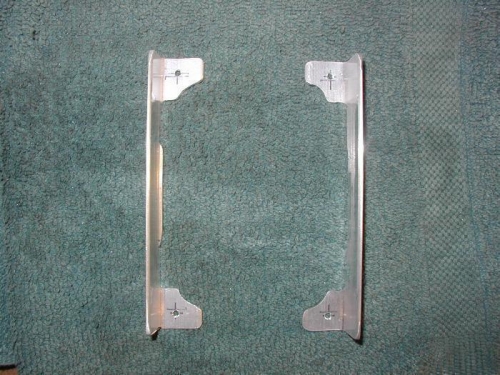

Trimmed the compass/clock template and located to the panel to draw the cutouts. Worked on vertical rail supports for the AirGizmo handheld GPS mount. As I want to have the mount for this as far to the right against the panel support on the left, I chose to turn the vertical mounts inward and secure with rivets to tabs in the top and bottom.
Template used to locate compass and clock
Vertical mounts for AirGizmo handheld GPS tray
Made for minimum clearance left and right
