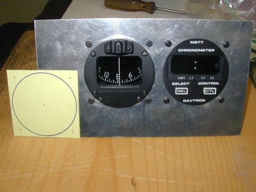

Brief Description:  Panel - Compass, Clock template
Using heavy paper, a template for the Davtron Digital clock and the Falcon Wet compass were created. This was then transferred to some scrap aluminum to test for fit and spacing. I decided to use a .250 inch space between the face plates of the two instruments. The aluminum template worked out fine. This can now be use for the cutout in the panel.
Compass and Clock in template
