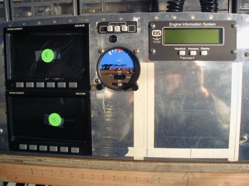

Date:  12-8-2007
Number of Hours:  8.00
Brief Description:  Cut panel for Annunciator and EIS
Added the Annunciator (center top) and EIS (right) to the panel today. Also shown is the TruTrak ADI Pilot II in the center. Needed to mount the Annunciator and EIS units so that I could determine the area of the panel in which to fasten the vertical rails for mounting the Radio stack below the EIS. It's tight, but should work fine. Next will be to cut the hole for the radios.
Dual EFIS, Annuciator, Autopilot and EIS
Different view of same
