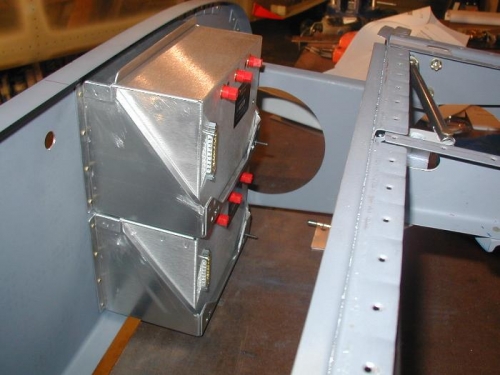

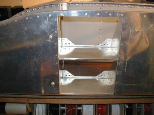

After much filing, the holes are now complete. Next I installed the 3/4 angle brace to re-inforce the panel. This required trimming due to the top (primary) D100 extends into angle some. Everything is straight, and solid. Next, the D100 mounting trays were riveted to the back of the panel.
D100 trays riveted in place

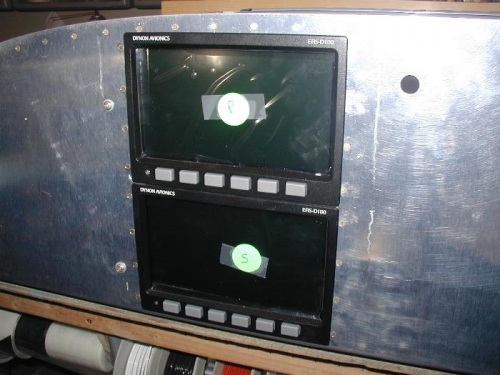

D100's in the trays
D100's in the trays
