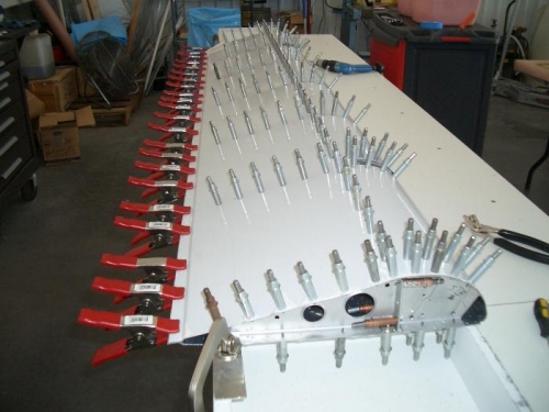

Brief Description:  Drill top skin

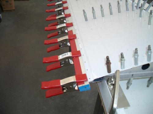

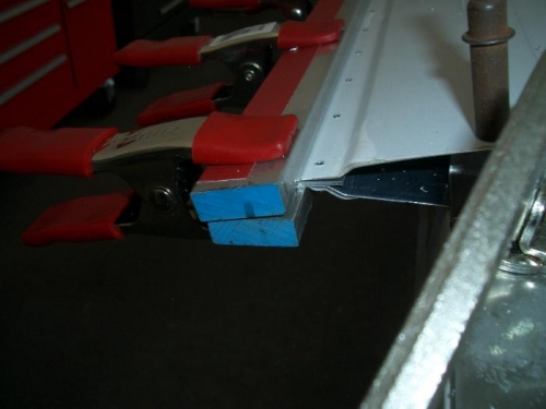

Drill top skin and cleco, drill trailing edge, cleco and finish trailing edge. Started on the front spar working my way outward then back on the aft ribs the forward on the nose ribs. Made 2 bar clamp for the trailing edge to keep it straight for drilling, then belt sanded the trailing edge to make the edge even and straight.
