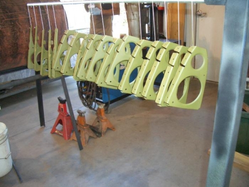

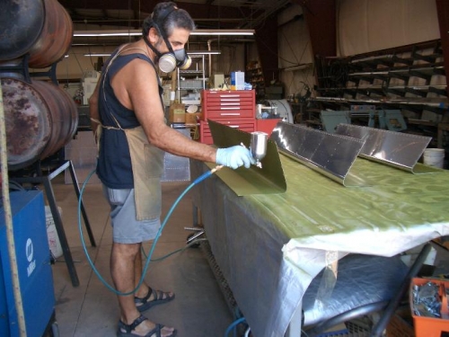

Prep and paint
Prep the top, bottom, and nose skins. All the ribs are alodined, and paint it all with zinc chromate primer!
