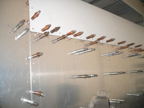

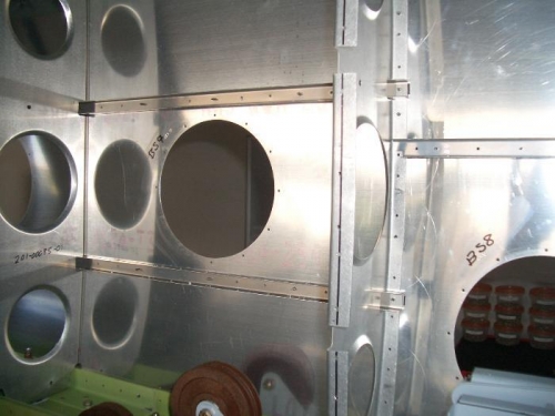

Install both the bottom and top skin stiffener chanels, drill out all the spar holes to 1/8 , deburr and dimple the hat sections and skin stiffeners. Deburr all the bottom skins, drill and mark all the access cover rings.
