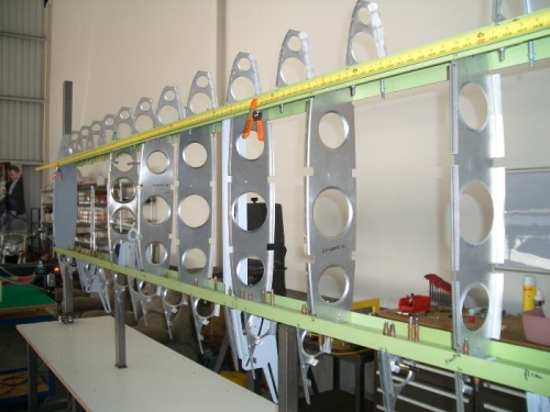

Brief Description:  Drilling Ribs

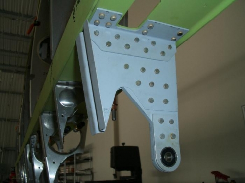

Drilling out main ribs and cove ribs out to .128 When drilling these out you have to line up holes and then align them with both the top and bottom of the spars, seems like the pre drilled locating holes are not really where they are supposed to be! Also riveted the inboard aileron bearing mount with flush #4's countersunk so the aileron bellcrank will sit flush when it gets mounted.
