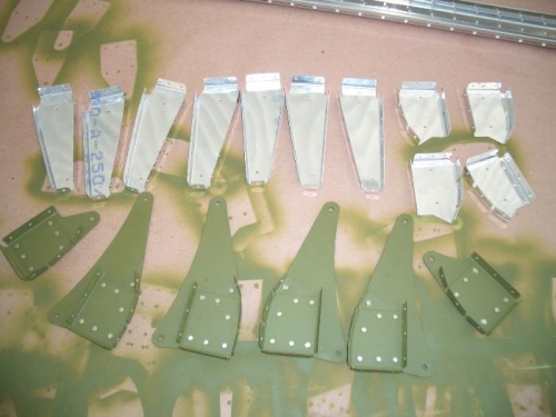

Remove cleco's
Remove cleco's and deburr all the holes dimple almost all of the holes, etch and alodine the ribs.
