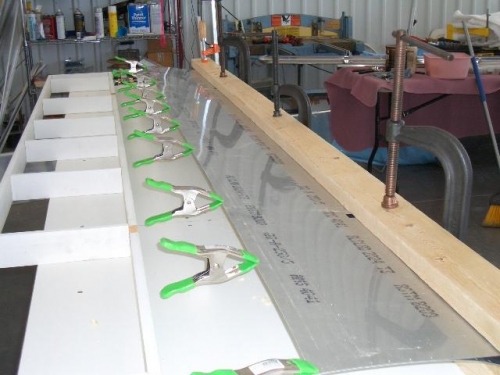

Brief Description:  Bend Flap skins
Made a jig out of a couple of 2X4's to sqeeze the leading edge radius of the flap skin. It worked pretty well made a little more defined bend rather than the smoother radius I was hoping for! The overall thickness measurement at the chord was reduced from 3" down to 2" making the fit to the nose ribs much better.
