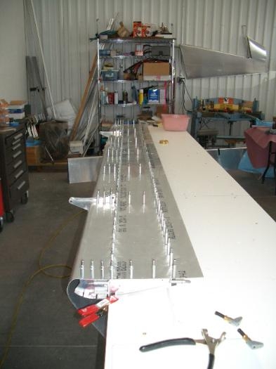

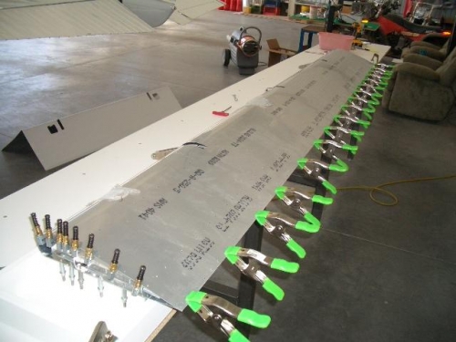

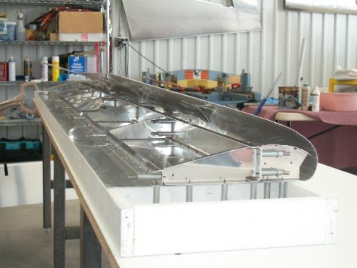

Fit the flap skin, build the wood shim for the back spar, and build the wood frame for clearing the clecos. The nose radius is a bit big leaving some gaps on the nose ribs. I think I will tighten the radius by pinching the skin between a couple of 2X4's so it fits better before I drill the top side!
Bottom of Flap
Bottom of Flap
Flap setting on Fixture
Top skin pulled down
