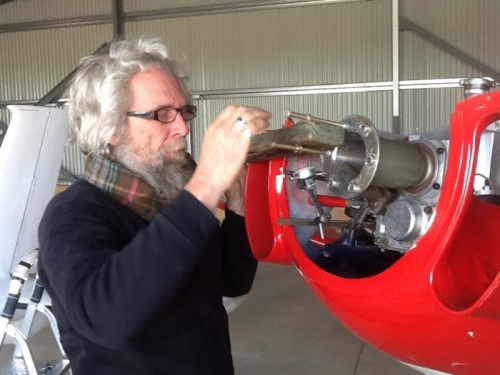

Removed prop and checked the propeller flange run-out. Found to be 1/1000" inch deviation. OK.

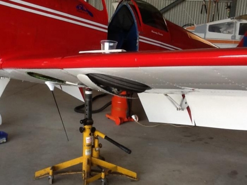

Checked undercarriage legs and found both were bent / twisted. Neither would fully retract. Possibly beyond repair.

Checking flange run ut
LH under carriage leg
RH undercarriage leg.
