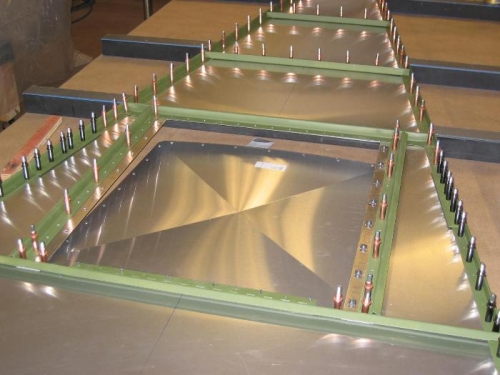

Date:  4-28-2007
Number of Hours:  6.00
Manual Reference:  6B3
Brief Description:  Bottom access door
ZAC design made sloppy when complete. Changed edge to recess into bottom skin with added strips and flush riveted nutplates around edge. This is similar construction to hatch covers in wing storage compartments. Don't understand why they didn't do same here.
