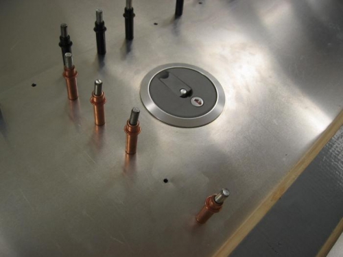

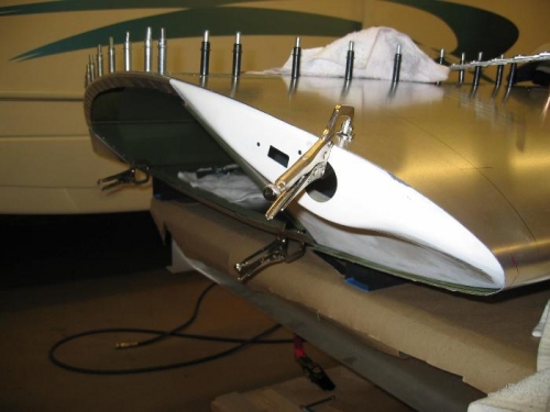

Shim fuel tank filler to flush with nose skin.Finish cleco on nose skin up to main spar.Finish fitting locker door and round corners.Start fitting forward fiberglass wing tip. - mix 5 batches of micro-balloon/epoxy filler to fiberglass to fit closer inside nose skin. (must dry overnight)Cut a plywood nose rib to hold correct nose shape at wing tip while fitting.
