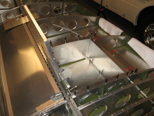

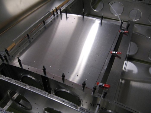

Install covers inside lockers.Play with Dzus Fasteners to understand how to install them in wing locker cover. Install on scrap aluminum.Ordered different "springs" for Dzus fasteners from ZAC.Measure, mark and cut formers for door/cover on locker. These worked slick to hold wing shape. Not hard to do either. I eventually added some corner reinforcements to the formers.
