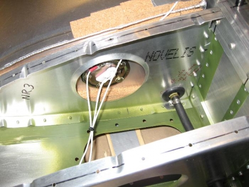

Brief Description:  Right Wing
Long day fitting long range leading edge tank. Two drain holes (Vent and drain) in lower nose skin not a big deal, however, getting tank "seated" with cork, and fill hole for gas cap cut-in was a bear. Almost finished now. Tank in and out of wing a dozen times. Still need to install fuel sender on end of tank, with wiring.
