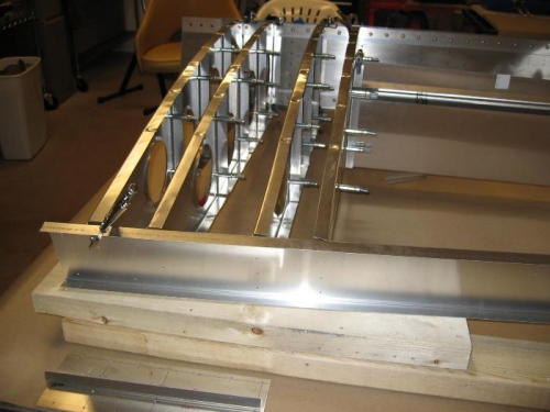

Long day, working on Right wing locker. Some unclear directions from engr. dwgs.Finally got RR#4 &5 stiffners located and pilot holes drilled.Appears that I'll need to trim height of rear panel of locker down about 3-5 mm from rib 4 to rib 5, no biggy. Will wait to do this after skin is riveted on.
