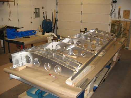

Brief Description:  Right Wing
Clamped rear spar on and lay out of centerline marks for RR attachment.Draw centerlines on RR (Rear Ribs) for wing skin attachment.Change clamping arrangement for main spar to hold 81 deg. angle required.Checking for level, but not necessary at this time.
