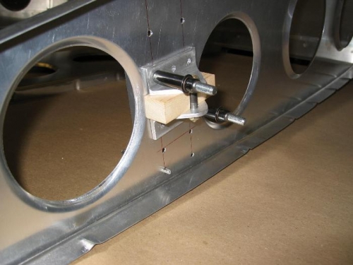

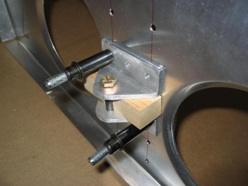

Brief Description:  Right Wing
More on Stiffners, more on Bellcrank supports.Am cross-checking various engr. drawings to attempt to avoid too many mistakes......takes time.Making Bellcrank brackets is slow. Wood spacers ( 16.5mm ) are in place until bellcrank is bolted inplace with castled nut. I need to Zinc Chromate the bracket and the support before that.
