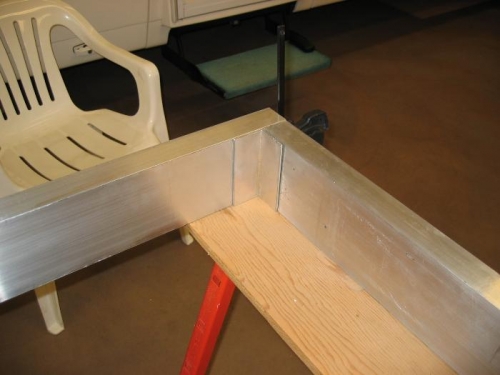

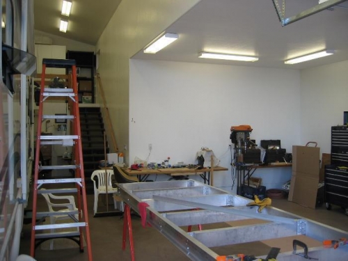

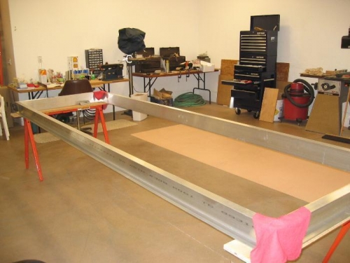

Brief Description:  Building work table
Using 5" 6061 T6 channel for framing 4' x 12' table top. .250 flat stock is bolted from side to side to stiffen frame and support center of table top. Ends of cross pieces bolted with 2"angle aluminum using (4) 1/4-20 bolts in each direction. Cross pieces have aluminum angle riveted along top edge to provide attachment point from underside for screws into first layer of top ply.2nd layer of ply (top sheet) held down with screws from bottom, so top is smooth.Top built separate from base to allow raising and lowering height as required to work. Top covered with double 3/4" finished 7-ply for solid/smooth work surface. Objective was "FLAT" and "level."Finished sub-structure was rigid and light-weight (I could easily pick it up alone) until ply was added.
