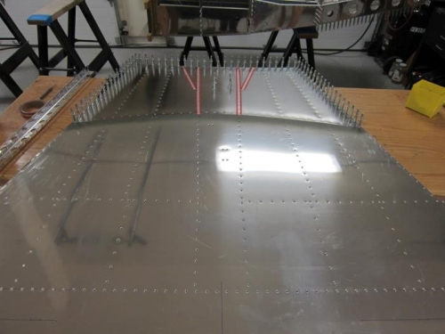

Brief Description:  Rivet Ribs to Forward Fuse Skin
Tonight, I began back-riveting the ribs to the forward fuse bottom skin, including the belly sheild sandwich of materials. Around the edges of the sandwich, I applied Fire Barrier 2000 caulk, which will help keep moisture (and fire) out.
