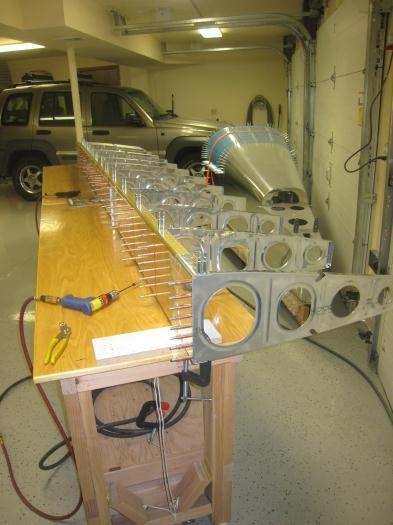

Today I finished match-drilling the left aft ribs to the spar and then match-drilled the aft ribs to the right wing spar in a similar fashion as the left. Lots of holes, and it was quite tedious, but I keep thinking, just wait 'till I get to the skins! ;)
