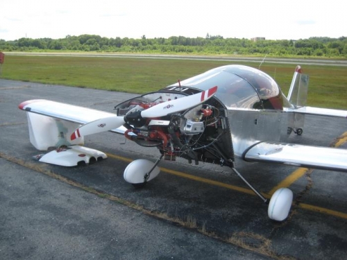

On the ground at FIT

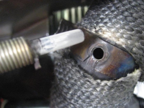

Broken EGT probe
Broken EGT probe

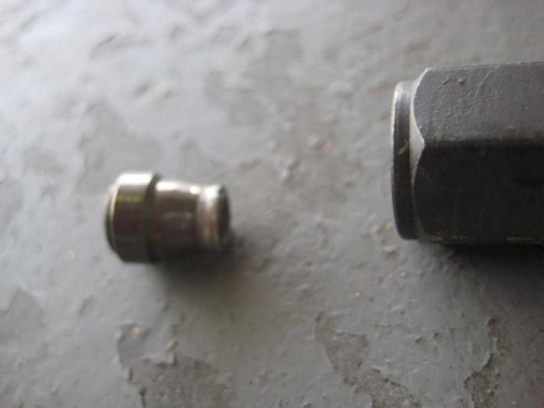

Broken smoke oil supply tube
