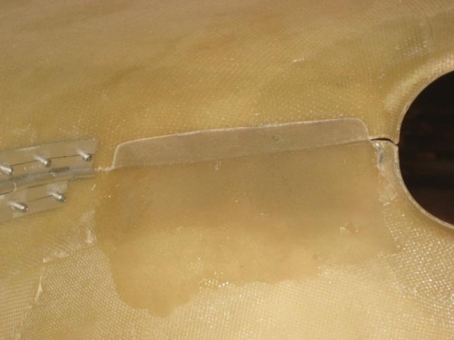

Trimmed forward "tabs"
Separated the two cowl halves, then used a Dremel cut-off wheel to trim the new "tabs." Then sanded them smooth and rounded the corners. Test fit, and they work well.
"Tab" trimmed about 1" above the cowl split.
Same on the right side.
