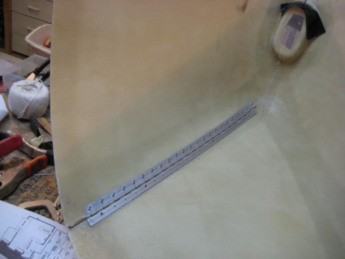

- Put the othe hinge half in place on the lower cowl's hinge half, and put the upper cowl in place with duct tape.
- As in photo 1, used the backlight method to locate the holes in the cowl with the holes in the hinge half. Jut 3 holes with clecos and then...

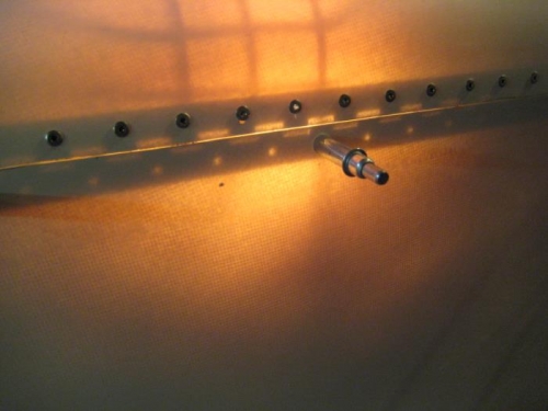

- I got smart this time and took the whole left cowl off to drill the rest of the holes (photo 2).
- After updrilling and deburring, I riveted that final hinge half in place.

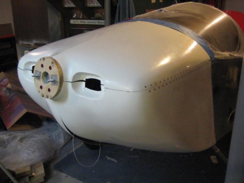

Photo 3 shows the end result. The left cowls came out much better than the right. Experience! I now want to locate the holes in the cowl to fasten to the already-installed floating nut plates along the front edge of the windscreen. That will show me what needs to be trimmed where the two upper cowls come together.
Backlight method to locate hinge holes in cowl
I got smart this time and took the whole left cowl off to drill the rest of the holes.
With all hinges in place! Now for some cutting and fiberglassing...
