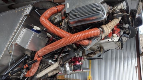

Photo 1: Scatt tubing reversed between top and bottom of muff.

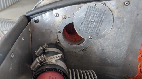

Photo 2: Supply opening put back to being only partially open.

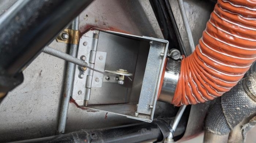

Photo 3: The reason a partially open firewall valve makes things COLDER is that the flapper valve is (in this photo) fully CLOSED, so no air gets in. When the valve is FULLY open the open valve lets in ONLY air from the scatt tubing; it blocks out any air from under the cowl. With the valve only PARTIALLY open it lets all the cold air from the lower cowl go directly into the cabin without being heated. Sonexes with a turbo setup may not have this issue since the turbo exhaust is in this general location and is very hot.

Swapped locations of the scaft tubing in the muff
Put the inlet hole back to the previous partially blocked opening.
This is why I think opening the valve only part way does not work.
