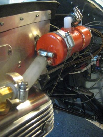

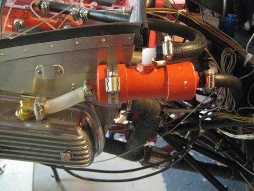

Brief Description:  Modified air/oil separator
If you saw my previous posts I was having trouble with the oil return line getting back to the fiting in the valve cover. The way I set it up the hose had to make a 180 deg turn, and every hose I tried would kink.
So I moved the air/oil separator back (aft) and could then put on a straight section of hose.
Side view.
Side view.
Front view.
Front view.
