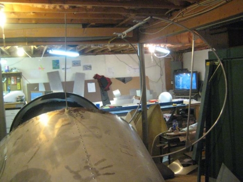

Brief Description:  Front canopy bow
Bent the forward bow, and gradually cut the ends off until I had the right bend and the right length. I used my knee a little for this bow, but I used my little bending jig a lot.
Like the rear bow I drilled the 8 holes required to fasten the steel corner brackets to the bow.

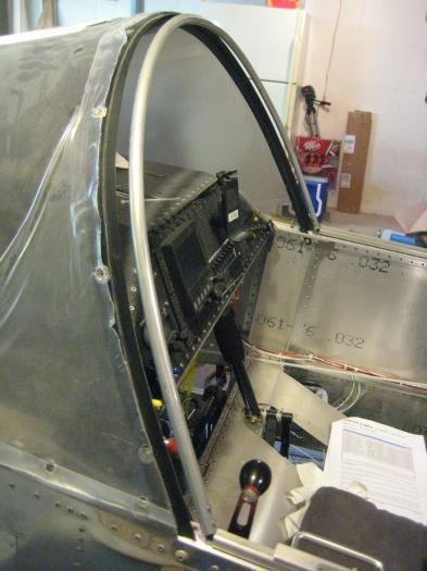

In photos 2 and 3 the frame looks complete, but I have not yet riveted the bows to the horizontal rails.
Front canopy bow successfully bent to match the windscreen arc.

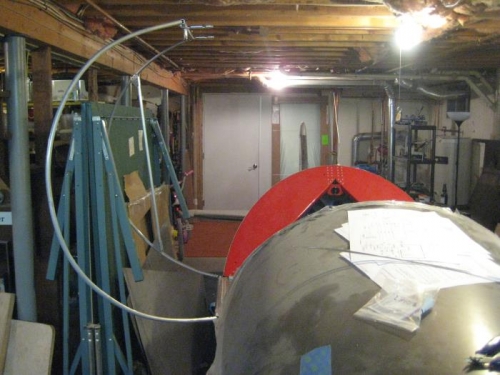

Both bows complete, and the whole frame swung open
Same thing, from the rear.
