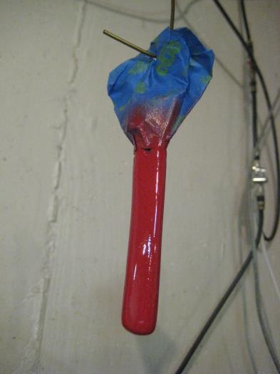

Finish fuel tank vent
With several layers of JB Weld, I now used files and a lot of varying grit sandpapers to work the final shape and get a smooth finish. Then after cleaning I painted with primer, and finally several coats of Rustoleum gloss red paint from a can.
Painted vent, hanging to dry.
