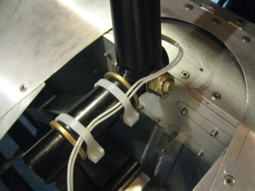

Brief Description:  Re-secure right side stick
The holes for the both the pilot and passenger-side sticks got wallowed when originally installed, so there was play in the sticks that I really didn't like. I fixed the pilot-side stick some time ago by upsizing to an AN5 bolt. Now I finally got around to it for the passenger-side. Now it's nice and tight!
New AN5 bolt.
New AN5 bolt.
