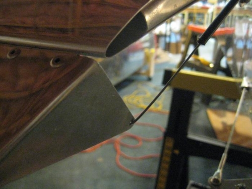

- Installed the wire housing (black, in photo #1).

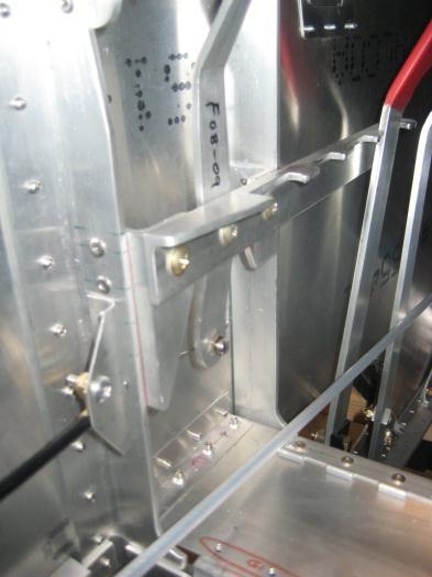

- Made the Z bend in the trim tab end of the wire, and installed it in the trim tab (photo #2).

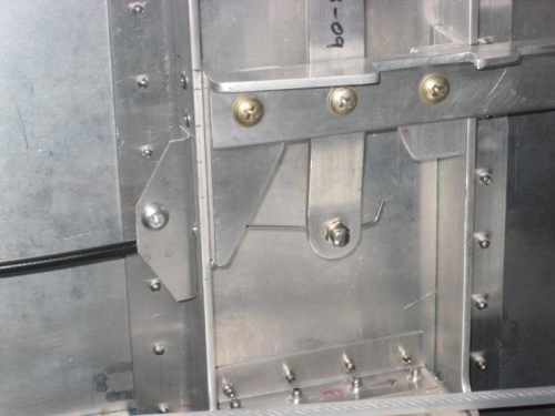

- Tightened down the screw on the swivel bolt and cut off the extra wire (photo #3).
Trim and flap notch assembly riveted in place.
Wire to trim tab installed.
The trim wire in place. I left extra wire just in case I need some more adjustment.
